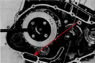

ok well its about time i changed to oil on the girlfriends bike but not sure where it is on an XL500 as ive had a quick look but cant see it
is it under the belly pan on the bottom of the engine then

Hello Del,
there´s no classic oil-filter avaible on the xl 500. They built a sifter at the place shown on the photo below.
Greetings
- Werner -
