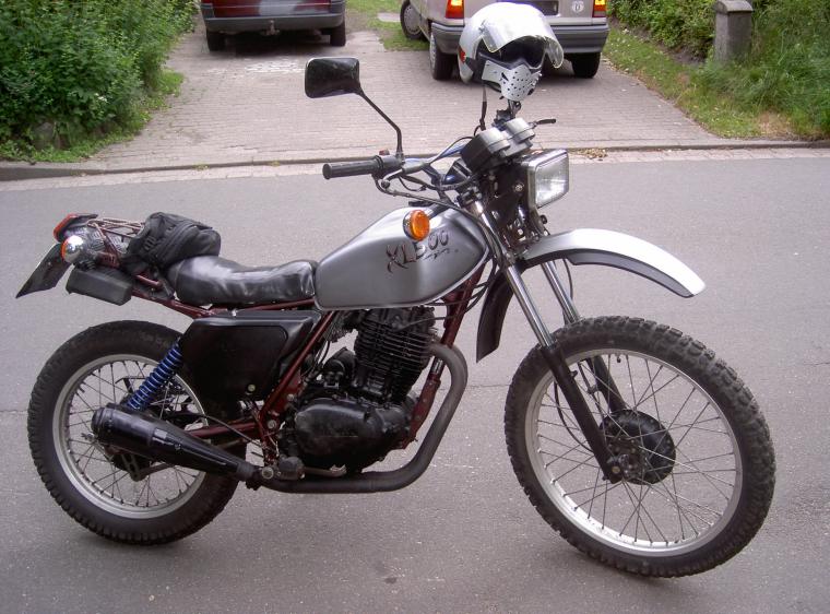

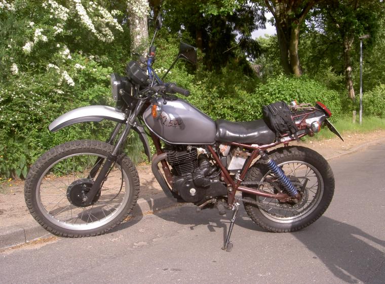

The FT-Engine fits - and doesn't fit. It's not only the exhaust manifold that causes problems:
1. The easy way (leaving the e-starter)
  • the whole exhaust system (XL) doesn't fit anymore (the e-starter (FT) hits the exhaust). You have to use the FT-Exhaust wich looks ... different (see pictures below). Or you have to remove the e-starter, wich leads to a lot of problems (see section 2).
  • The ignition system is different (you have to change the C.D.I)
  • The XL-Battery is to weak for the starter. You have to find a place for a bigger battery.
  • The wiring harness is different
  • The outputshaft (FT) is about 5 mm longer, the pinion is placed the same distance outer. This results in a diagonal running chain. You can probably build a distance-ring, wich corrects this.
2. The hard way (removing the e-starter)
If you remove the e-starter, you need to demount the complete engine to place a kickstarterspindle into the gearbox (use the 18-mm-Version of the S-Model). You can put the XL-Gearbox in the FT-Crankcase to solve the "Outputshaft-Problem" and replace - by the way - easily the outputshaft sealing [not the bearing, as I wrote first]. Additionally you have to replace/modify the following parts:
  • the right crankcase cover (the one from the FT doesn't have a hole for the kickstarterspindle). Use the S-Type-Cover (witch fits on the 18 mm Kickstarterspindle)
  • use either the whole ignition system of the XL or the FT. Don't forget to change the sensor in the right crankcase-cover or the pick-up on the right crankshaft side
  • drill a new hole in the engine crankcase for the engine air vent
  • put a XL5R-Magnetwheel on the left crankshaft side
  • use a XL5R-Generator
  • replace the left crankcase cover. Use the one from a R-Model.
Doing all this is a lot more work than searching for a good XL-Engine! It's still far less work to rebuild the XL-Engine using FT-Parts (like volkri said).
Creetinks,
P.S.: The pictures can only been seen, if you are logged in!
Udo already placed a FT-Engine in the frame of a XL - 1
Udo already placed a FT-Engine in the frame of a XL - 2
