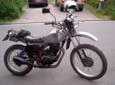

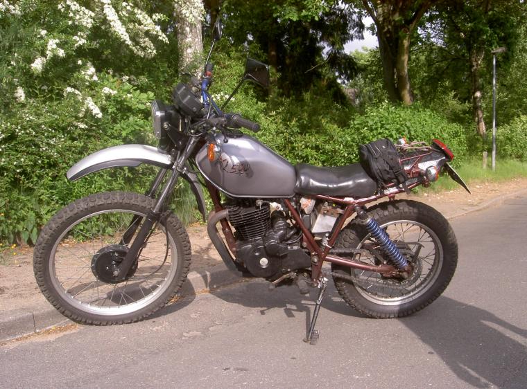

The FT-Engine fits - and doesn't fit. It's not only the exhaust manifold that causes problems:
1. The easy way (leaving the e-starter)
  • the whole exhaust system (XL) doesn't fit anymore (the e-starter (FT) hits the exhaust). You have to use the FT-Exhaust wich looks ... different (see pictures below). Or you have to remove the e-starter, wich leads to a lot of problems (see section 2).

Udo already placed a FT-Engine in the frame of a XL - 1
Udo already placed a FT-Engine in the frame of a XL - 2
