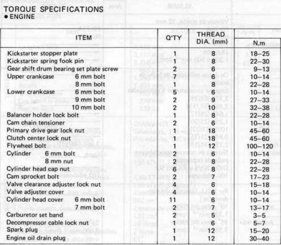

Soon the time to assemble the cylinder head and valve cover. As a motor rookie I am very uncertain. When I look at my Haynes I can find different figures for torque.
I would appreciate your experience.

That's right, there are 6mm and 7mm and camsproket. Take a look to the picture.

Hello Happyswed,
you did asked us to our experience.
The M6 thread must withstand exactly 10Nm. Not more not less. When the threads run away you need thread-inserts from "HeliCoil" or "TimeSert" or "Ensat". The aluminum cylinder head is very soft.

Many thanks for your info!
I have now made the first test with the 4 off M6 bolt to the Valve adjuster lid. I use 10 Nm and it was OK.
