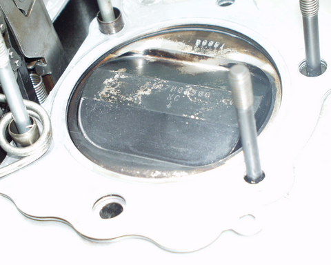

Hello. Can somebody help me.... I have bought a new Wiseco std bore piston... in witch direction shuld arrow on piston point??? "up" or "down"
Up- arrow is pointig on side where is carburator
Down- arrow is pointing on the side where is exhaust
Usualy you need to put piston that arrow is pointing "up" but in user manual for this wiseco piston says that you need to put piston in that way so arrow on the piston is pointing to exhaust. Is that right????
And how shuld I arrange piston rings gap's?
I understand no nothing. How can an arrow on the surface of a piston point "up" or "down"?
Creetinks,
The arrow of my wiseco points towards the exhaust (see picture).[...] but in user manual for this wiseco piston says that you need to put piston in that way so arrow on the piston is pointing to exhaust. Is that right????
Turn them 180° each.And how shuld I arrange piston rings gap's?
